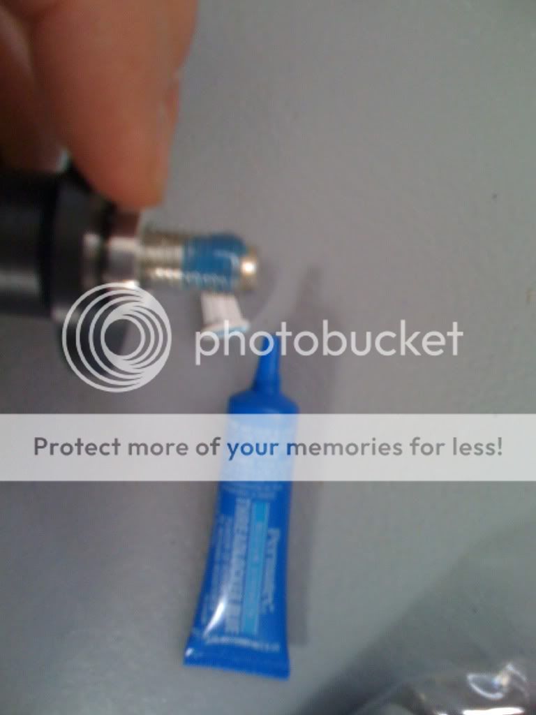

I installed the swingarm sliders first as it is super fricking easy. Here's a breakdown of the spools
A little blue locktite

I locktited the bolts, and set the torque wrench to the suggested 10 ft lbs. Gave it a couple bounces past the click for good measure, put that side's fairing back on and voila, time to mount the slider puck. Again with the locktite...notice a pattern here?!
