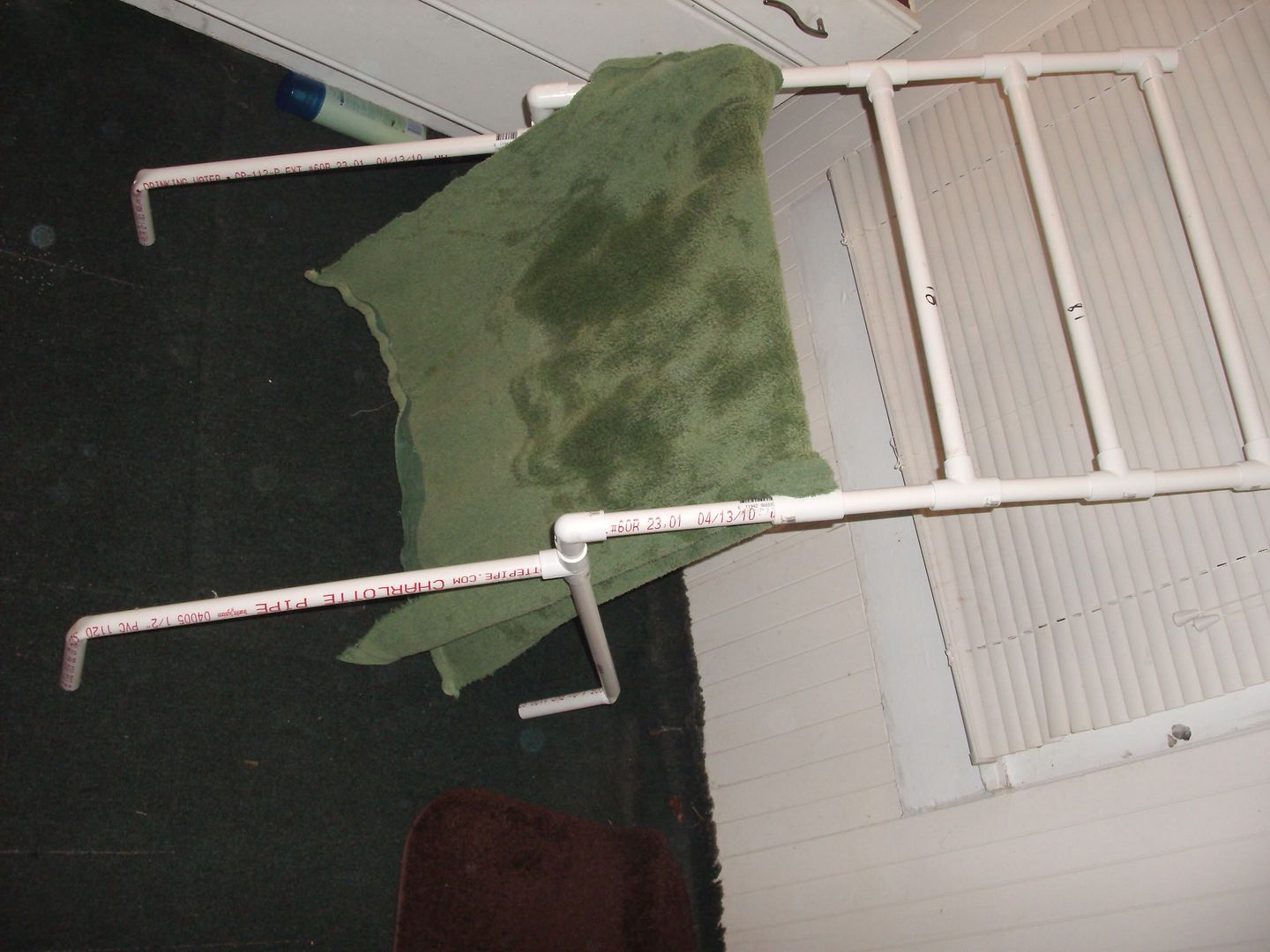

Now this is the finished product and what yours can look like 'I forgot to grab a can of Krylon spray paint to make it prettyful so forgive its crudeness at the moment'.

Cut the pipe to pipe adapter 1\2 - 2\5th's from the opening, lather glue\epoxy on the side you cut and place the cut piece at the crux on the T adapter 'leaving it on its side' so that gravity will hold the glued piece in place. as pictured below.

Place 1 18" pipe piece in the glued adapter you placed on each T adapter allowing it to stand on its own. 'This is the time to twist the legs so they hug the ground well and get it as stable as possible.'
Find those two pieces of pipe you put off to the side with the 90\45 degree elbows attached.
Place them in the upper most part of the T adapter and align it so the opening faces in parallel with the lower legs.
Now I found 7" was perfect for this next part 'experiment by placing your hands at different heights to determine how high you like yours'.
Place the two cut pieces in the tops of the 45\90 degree elbows facing back over the legs 'so that the center of gravity will be almost perfectly well centered'.
Now that you have done this.
Place one T adapter on each 7in length with the T part pointing in and place 1 18" piece in there ensuring that it is nice and tight to help stabilize the structure.
Cut 5in lengths 'you will need 6 all together'. Now place one on the end of the two T adapters and place another 18" rod in there as before.
Do this until you have finished.
