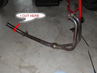

i saw this so i did it.

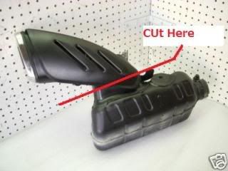

I got the stock exhaust from my brothers 2007 gsxr 600. And just cut it where the line is(just make sure to take OFF the cover you DONT want to cut that)
Then i took off the whole header and cut it where the line is.(but you dont have to its up to you how short you want it but i think i did it as short as possible)

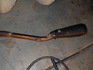

Last step just weld it together like my first pic. youre going to need an extra pice of metal to cover that big gap and thats it just put it back together and youre ready to go.(its my first time on this forum i tried to explain it as clearly as possible)

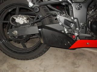

Mistu: Looks like you got rid of the giant muffler chamber that sits before the tip... How loud is that exhaust? I've always liked that look since I first saw it... I think it goes great with the little Ninja's looks. I think most big cans on the big bikes really mess up the flow of the lines on the back of the bike.

Yea the exhaust sounds really good, but I'm not fond of cutting up my stock header or muffler. I've seen 2 variations of fabricating this. I'd rather go the more safe way. and that's redrider's exhaust. But this one sounds and looks great

Yeah you have to really think if you want to do this. i got a brand new stock header off this guy for 40 bucks so i just did it but keep in mind youre going to have to rejet if you do it. for now the bike runs sweet ill keep you guys posted if it gives me problems.

Why would you need to rejet? What exactly is rejetting?
92 Posts
Rejetting is when you change the jets in the carbs to get the engine more fuel, which is needed when aftermarket exhaust systems are installed. I had a new exhaust put on, and ride it some without the rejet, and it did not run very well. After the dynojet kit was installed, bike ran great.
